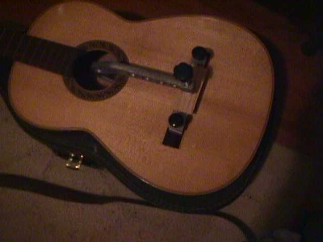

I got in an old Classical guitar from a family that had a bad separation of the sound board. I rehydrated the wood and it came together to this point. This is a no named guitar, but has been in their family for 75 years so I am treating pretty gentle. I have to replace the bridge, but here is my question.
I don't want to remove the top, does anyone have any tricks on hiding or doing away with this last line you can see. I plan to clete the board from inside the box using small squares to hold in place. Any thoughts?

Without removing the top all I would know to do is to make splits to fill the gap. What does it look like a the roseete?
PostPosted: Fri Aug 25, 2006 5:07 am
MichaelP
the line diappears coming up to the rosette and the rosette area itself is still good. I have found that these older guitars, especially the classicals are really tough to disassemble without creating additional damage. The crack originally was about twice the width and the guitar was clearly very dry, so adding some moisture sponge and baggy allowed it to correct to this point. The binding and purfs are in excellent shape.
PostPosted: Fri Aug 25, 2006 5:55 am
Then a splint I think is the way to go to keep the integraty of the guitar togather. I will likely be noticeable due to the aging of the top but at least it would make the top stable. MichaelP38954.6347453704

it looks as if the seam is still gaping a bit. if so, does it close when you squeeze the top laterally?
if so a splinting is probably unnecessary, but the seam needs to be cleaned out and reglued before installing the cleats.
and from the photo it also looks as though the bridge was glued slightly off to the bass side; maybe an optical illusion of the photo. crazymanmichael38954.8749884259
PostPosted: Fri Aug 25, 2006 12:30 pm

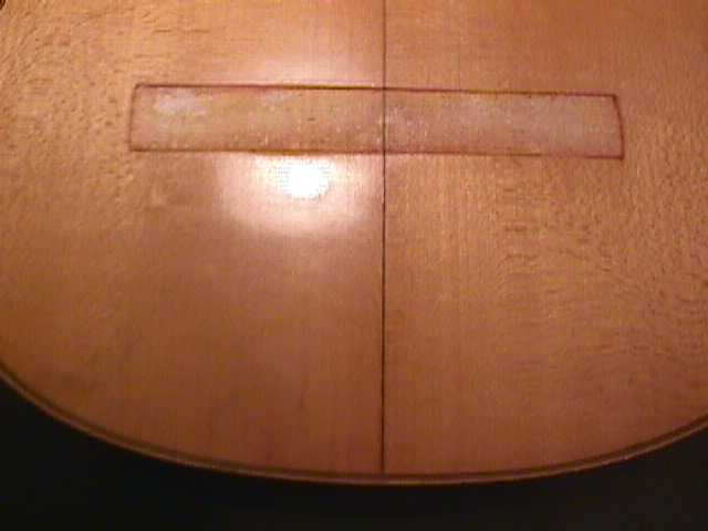

Michael, the gap is about a razor blade wide now. The guitar is pretty solid and applying pressure from any direction is not closing up this final fine line. I think the bridge was an illusion, however, I am going to verify the set to make sure. After some additional inspection with a mirror and by touch, it appears that the crack is completely closed inside the box. So I am going to proceed with the splint, glue it in and then cleat the inside of the box.

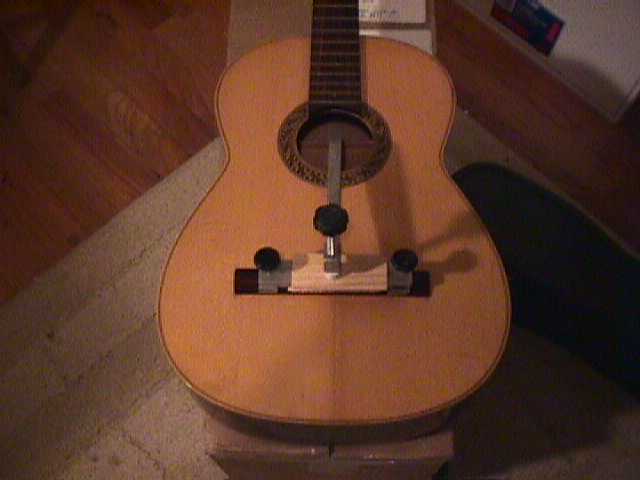

Just wanted to thank all you guys and show a couple of pics of the repair. I have a little clean up to do and matching the wood was difficult, but I used the best match I had. The crack is gone and after I clean it up and polish I think it will look great. I did the splint method referred to above. Thanks for your help.
Michael, the bridge was off a little and I made the adjustment, thanks for pointing that out.
At any rate, all is secure and the bridge is glued and clamped as you see.
